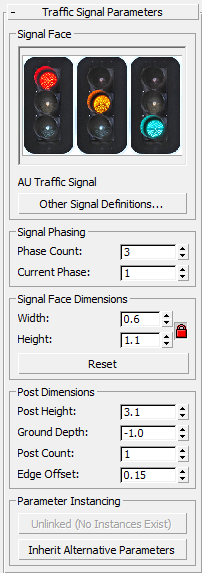

Provides controls for traffic signal objects.
In general, when you use the Object Placement Style Editor to place a series of parametric objects in a single SOS element, the objects are linked as instances. This means that changing any of the following parameters affects all objects in the set. To unlink such instances, please refer to the topic Parameter Instancing.
Parametric traffic signals in Civil View use a single sign face map that is divided into a number of separate horizontal segments. By varying the texture coordinates of the sign face geometry, Civil View displays only one of these segments at any moment. This makes it possible to switch between segments of the bitmap to create the illusion that the signal is changing. You can even animate these parameters.
Bitmap with three phases of a standard stoplight
This technique can be used to represent any sign that uses dynamic sign face content; for example, variable-message signs and matrix signs.
By default, these values are derived from the Civil View Sign Library INI file for the selected object.
[Lock] When on, constrains the Width and Height values so the signal maintains a consistent aspect ratio. Resets the signal sign face dimensions to those specified in the original INI file.
By default, this value is derived from the Civil View Sign Library INI file.
