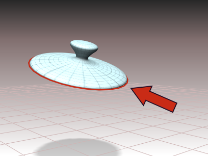

Creating a curve from a surface edge
To create a surface edge curve:
The NURBS object must contain at least one surface.
The curve resides on the edge closest to the two seed values. Adjust the seed values to change the edge on which the curve resides.
This lets you replace the parent surface. Click a button, then click a surface to replace the original parent surface.
