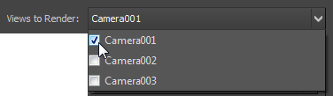

- Views to Render
- Choose views to render. With
3ds Max, Autodesk Rendering renders only camera views. By clicking Render, you can launch a rendering of more than one camera view.
