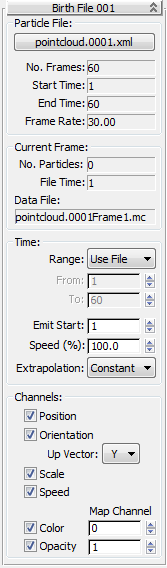

  10. To see what's causing this, open Particle View and click the Birth File operator in Event 001. Its name should be "pointcloud (pointcloud.xml)."
    The operator parameters appear on a rollout on the right side of the Particle View dialog.
  11. Scrub the time slider and note the parameters whose values change: No. (Number of) Particles, File Time, and Data File.

The user interface appears in the parameters panel, on the right side of the Particle View dialog.
Particle File group
Contains a button that shows the name of the XML point-cloud file that defines the particle-birth parameters; to choose a different file, click the button and use the file dialog that opens. This group also contains read-only, basic data about the particle file, including the total number of frames, start and end times, and the animation frame rate.
Current Frame group
Read-only particle data for this frame only (change the frame with the time slider). Shows the total number of particles, the frame number of the active MC file for this frame, and the name of the MC file.
The current frame data are of interest if the Speed (%) value (see following) is not 100.0. In such a situation the current frame in 3ds Max might not be the same as the active MC frame, so this group tells you which frame of the nCache file Particle Flow uses to populate the current frame. For example, if the current frame is 30 and the Speed (%) value is 80.0, the File Time value is 24.
Time group
Range
Choose how to set the frame range for the particle birth:
  • Use File Obtains the frame range from the point-cloud file and uses it to fill in the From and To values.
  • Custom Lets you override the frame range in the point-cloud file by setting From and To values (see following).
From/To
The range of the MC files used to emit particles. For example, if you set set From to 5, the particle emission starts with the fifth MC file. When Range is set to Use File, these settings are unavailable and use the values from the point-cloud (XML) file specified by the Particle File setting.
Emit Start
The frame at which particle emission starts. The first frame of particle emission uses the MC file specified in the From field (see preceding), and proceeds to the subsequent MC files for the remaining frames.
Speed (%)
A multiplier for the speed of the particles defined in the MC file sequence. The default value, 100.0, uses the original particle speed.
Extrapolation
Determines what happens when the current time is outside of the specified time range (see From/To, preceding). When Extrapolation is set to Constant, the particles remain present and immobile when the current time is outside the range. When Extrapolation is set to Off, the particles simply disappear outside the range.
Channels group
Use these toggles to specify which data channels to use from the MC file sequence. The point-cloud (XML) file specifies the channels for which data is available; channels without specified data are unavailable in this group.
Position
When on, position information from the MC file sequence is applied to the particles in Particle Flow. When off, you can modify particle positions with Particle Flow operators.
Orientation
When on, orientation information from the MC file sequence is applied to the particles in Particle Flow. When off, you can modify particle orientations with Particle Flow operators.
Up Vector
Determines the vector reference for rotations read from the file; choose Y or Z from the drop-down list.
This setting can compensate for the fact that various programs use different axes for the vertical direction. Maya lets you choose between Y-up and Z-up, Softimage uses Y-up only, while 3ds Max uses Z-up. Because the incoming particle file does not specify the up vector, you need to choose it. The default is Y-up because it will be the right convention most of the time.
You can observe the effect of this setting if you use the Shape Instance operator in your event with Orientation (see preceding) on in the Birth File operator. If you use a cone, for example, you will see that the final orientation of the particles depends on the Up Vector setting.
Scale
When on, scaling information from the MC file sequence is applied to the particles in Particle Flow. When off, you can modify particle scaling with Particle Flow operators.
Speed
When on, speed information from the MC file sequence is applied to the particles in Particle Flow. When off, you can modify particle speeds with Particle Flow operators.
Color
When on, color information from the MC file sequence is applied to the particles in Particle Flow. When off, you can modify particle colors with Particle Flow operators.
Use the numeric setting to specify the map channel to which the incoming color information should be applied. This value must be used in the material associated with a Material Static operator.
Opacity
When on, opacity information from the MC file sequence is applied to the particles in Particle Flow. When off, you can modify particle opacity with materials, via Particle Flow Material operators.
Use the numeric setting to specify the map channel to which the incoming opacity information should be applied. This value must be used in the material associated with a Material Static operator.
