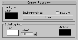

The Environment panel lets you assign and adjust environments such as the scene background and atmospheric effects. It also provides the exposure controls.
Use the Environment panel to:

Environment. To set the background color:
Environment. The Environment panel appears.
A Color Selector appears.
The Renderer now uses this color as a background.
To choose an environment map:
You adjust the map's parameters with the Material Editor.
Environment (or press 8). If you choose Bitmap as the map type, a file dialog appears so you can choose the image file.
On the Environment panel, the name of the Environment Map button changes to show the type of map you chose, and Use Map turns on.
After setting up the map, you can test-render the scene without the mapped background by turning off Use Map.
You have set up the environment map, but to change the bitmap or adjust map parameters, you need to use the Material Editor.
You can also create a standalone map in the Material Editor first, and then choose it with the Material/Map Browser.

To change the color and tint of global lighting:
Environment. A Color Selector appears.
Shaded viewports update to show global lighting changes.
3ds Max uses the global lighting parameters when you render the scene.
To change the color of ambient light:
Shaded viewports update to show ambient color changes.
3ds Max also uses the new ambient color when you render the scene.
The color of ambient light tints the scene. For most renderings, the color of ambient light should be black.
To change the intensity of ambient light:
Shaded viewports update to show changes in the ambient light intensity.
The intensity of ambient light affects contrast as well as overall illumination (the higher the intensity of ambient light, the lower the contrast). This is because ambient light is completely diffuse, so the angle of incidence is equal for all faces. Ambient light alone cannot show depth.
