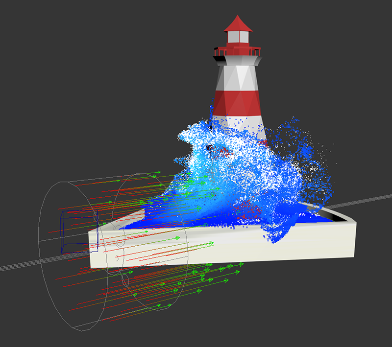

Use motion fields to apply forces to particles, fluids, and vertices.
A motion field influencing a fluid simulation, shown with velocity grid enabled.

Display rollout
- Velocity Grid
- When enabled, visualizes the effect of the motion field by displaying a grid of colored arrows in the viewport.
Note: The displayed arrows do not accurately reflect turbulence when Worldspace Turbulence is enabled.
- Resolution
- Sets the number of arrows displayed in each direction.
- Draw Scale
- Sets a scaling factor for the arrow lengths.
- Draw Time
- Sets the number of time steps for drawing the arrows. Larger values produces longer arrow trajectories.
- Color Options
- Sets an option for coloring the arrows: either Solid, Color By Age, Color By Direction, or Color By Velocity.
- Start Color
- Sets the color for the lowest values of the selected color option. When Solid is selected, this swatch selects the solid color.
- End Color
- Sets the color for the highest of the selected color option.
- Sample Options
- Sets the sample options: either Fluids, Particles or None. When working with fluid simulations, use the Fluid option to get a more representative visualization of the effect of the motion field.

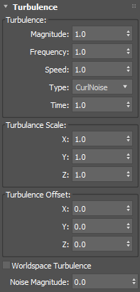

Turbulence rollout
Turbulence group
- Magnitude
- Sets the strength of the acceleration caused by the turbulence field.
- Frequency
- Sets the granularity of the turbulence. Higher values produce smaller, denser vortices.
- Speed
- Sets the rate at which the turbulence pattern evolves over time.
- Type
- Selects the algorithm used to generate the underlying turbulence pattern.
- CurlNoise is based on a simple noise field.
- CurlFractal uses several iterations of noise at different scales and speeds, creating a mix of larger and smaller vortices.
- Time
- Sets the time used to look up the current turbulence pattern. By default, this is driven by the scene time but you can disconnect it if you want to control the turbulence pattern's evolution independently.
Turbulence Scale group
- X
- Scales the turbulence pattern along the X axis.
- Y
- Scales the turbulence pattern along the Y axis.
- Z
- Scales the turbulence pattern along the Z axis.
Turbulence Offset group
- X
- Translates the turbulence pattern along the X axis.
- Y
- Translates the turbulence pattern along the Y axis.
- Z
- Translates the turbulence pattern along the Z axis.
- Worldspace Turbulence
- Sets whether positions in the turbulence field are considered in world space or in the local space of the motion field. Enable this option to:
- Scale the motion field without stretching the turbulence pattern.
- Translate or rotate the motion field without dragging the turbulence pattern along with it. For example, you can animate the motion field and have the boundary 'swim' through the turbulence pattern.
- Noise Magnitude
- Sets the magnitude when Noise is enabled.
