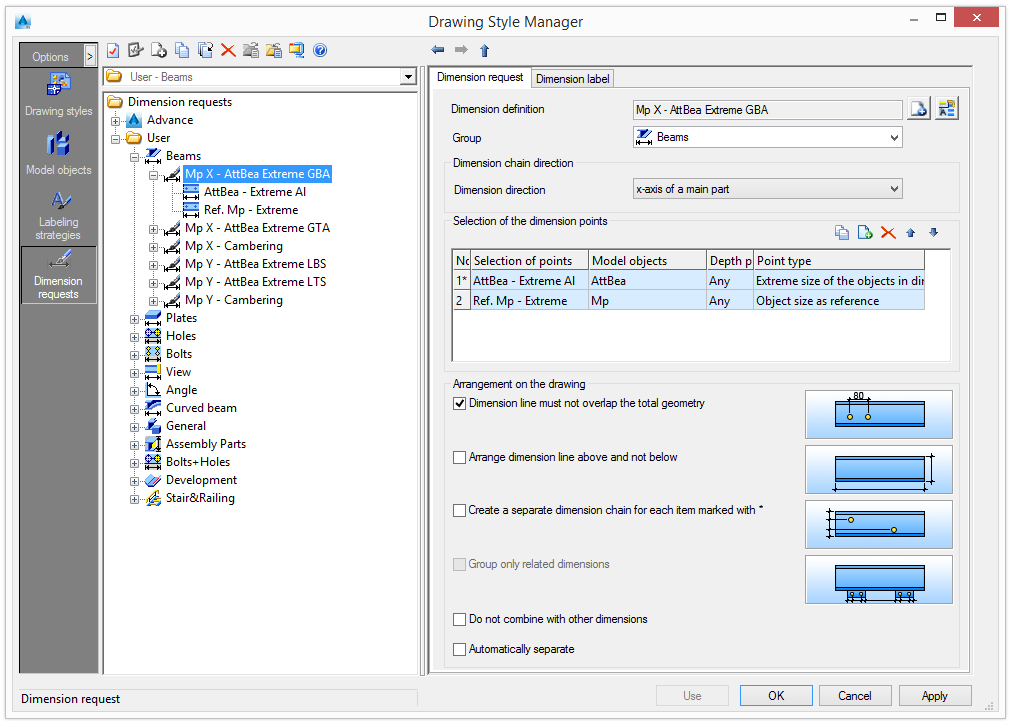

Set different options for the dimension direction, selection of dimension points or dimension chain positron by accessing the dimension definition properties.
The existing dimension definitions can be renamed and new definitions can be added.
Button | Function |
Define a new dimension definition. A copy of the current settings is created that can be moved to another group using the Group drop-down list. A new item appears in the tree panel under the specified group. |
Rename a dimension definition. The current settings are saved under a different name. |
