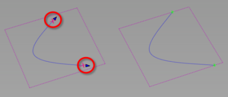

Extend a curve that does not project entirely on the patch, either automatically or manually, and continue the trim operation without leaving the tool.
When the trim fails, any curves-on-surface that are within the set Tolerance of another curve-on-surface or boundary are extended and the trim is attempted again.
A trim extend arrow appears on the curve that needs extending. Clicking the arrow snaps the end of the curve to the patch edge.
