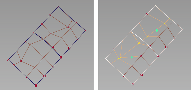

Planarizes surface hulls.
Single – Affects a single CV row.

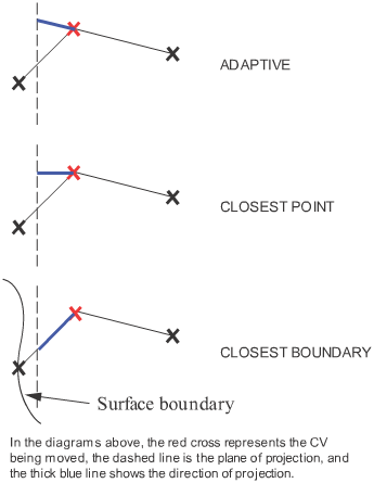

This option determines the direction of projection for each CV.
Adaptive – The direction of projection is along the hull line that is closest to the perpendicular of the plane.
Closest point – The direction of projection is perpendicular to the plane.
Closest boundary – The direction of projection is along the hull line toward the closest surface boundary.
If this option is checked, a deviation measurement showing the maximum deviation between the old and new surface appears.
If this option is checked, a green proxy of the original hull appears after the planarization operation.
