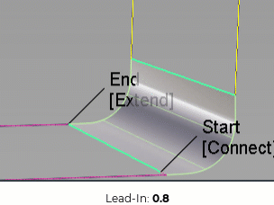

Lead-In
(Appears for the G2 Curvature/Arc Section Type only.) Sets the length of the fillet lead-in. For best results, turn on Auto Adjust Sliders while adjusting this value.

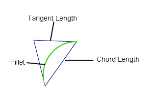

Chordal Type
Chordal length – a chordal length is specified in the field below.
Tangent length – a tangent length is specified in the field below.
This option is only available when Construction Type is Chord.
Chordal Length/Tangent Length
The distance to maintain between the two sides of the fillet, or the length of the tangent segment (see picture above).

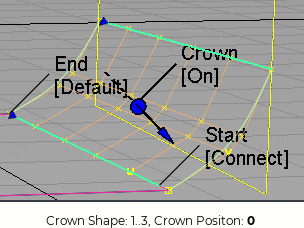

Proportional Crown
For G0 Chamfer section type only. Select this option to raise or lower the midpoint of the surface between two input curve sets so that the height or crown of the surface is proportional to the distance between the curves. The setting makes the surface degree 2 with a single row of CVs in the center. This option is not available when more than two curve sets are selected.
You can control the Proportional Crown directly on the surface.
Crown Flip
Flips the direction of the crown.
Click the arrow of the proportional crown manipulator to Flip the crown direction directly on the model.
Crown Value
Controls the height of the crown. The value corresponds to a percentage of the distance between the two rails. The slider ranges from 0.0 to 0.1, but larger values can be entered into the field.
Crown Shape
Increase the degree of the surface from 2 to 3, giving two central rows of CVs. Shape values less than 1 move these CVs closer to the edges of the surface, positive values move them closer to the center.
Crown Position
Controls the U direction of the crown shape from the middle of the fillet surface toward either input surface. When set to 0, the crown shape is at the middle of the fillet surface. Increasing or decreasing this value moves the crown shape towards either input surface. Crown Shape must be set to a value greater than 0 before Crown Position has any effect.

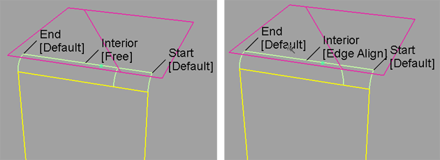

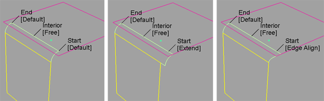

Flow Control
Start/Interior/End
Controls how the fillet surface(s) edges (in the V direction) meet up with the edges of the boundary surfaces.
Edge align – The tool tries to colinearly align the fillet surfaces’ edges or isoparms (for single surface) to the edges of the boundary surfaces in the V direction.
Extend – The fillet is extended so that it reaches to the end of the longest boundary surface, at its start and/or end.
Default or Free – The edges (in the V direction) of the fillet meet the boundaries at a 90 degree angle.
Clicking the labels on the model lets you cycle through all the possible values.
Possible flow control values for Start of fillet
Possible flow control values for Interior of fillet
