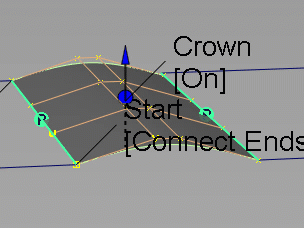

Proportional Crown
Select this option to raise or lower the midpoint of the surface between two input curve sets so that the height or crown of the surface is proportional to the distance between the curves. The setting makes the surface degree 2 with a single row of CVs in the center. This option is not available when more than two curve sets are selected.
You can control the Proportional Crown directly on the surface.
Crown Flip
Flips the direction of the crown.
Click the arrow of the proportional crown manipulator to Flip the crown direction directly on the model.

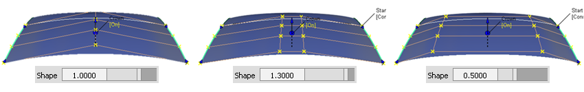

Crown Shape
Increase the degree of the surface from 2 to 3, giving two central rows of CVs. Shape values less than 1 move these CVs closer to the edges of the surface, positive values move them closer to the center.

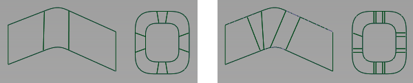

Curve Coupling Tolerance
When Explicit Control is selected, the skin surface may have an irregular structure. Increase the value of this option to improve the structure.
Left: Explicit Control not selected, Right: Explicit Control selected
