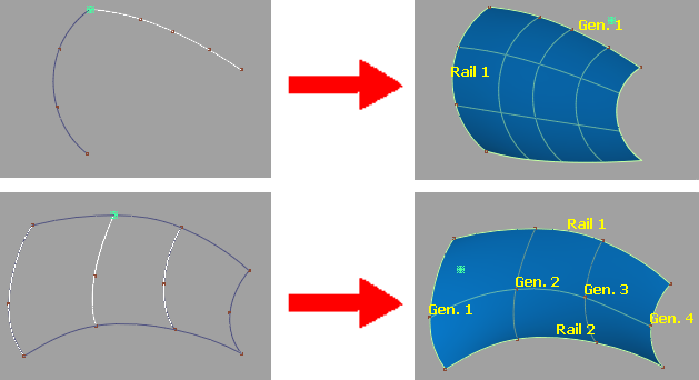

| Generation Curves | 1 | 1 | 2/2+ | 2 | 2+ |
| Rail Curves | 1 | 2 | 1 | 2 | 2 |
1 – Sweep one generation curve along the rail curves.
2 – Blend between a start and end generation curve along the rail curves. Use the Gen. Blend Value slider to control the midpoint of the blend.
2+ – Blend between a series of generation curves along the rail curves.

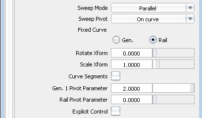

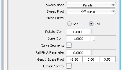

Sweeping involves two pivot points:
You can have Rail Surface set the pivot points automatically (as in Extrude), or set them manually for the generation and rail curves.
Off Curve – Set the pivots to a specific parameter on the rail curve and a 3D point in space for the generation curve.
On Curve – Set the pivots to specific parameters on the two curves.
Closest – Set the pivots to the closest points on the two curves.
This option is the default. It works best when the generation curve is close to the start or end points of the rail curve.

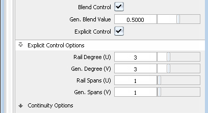

Turn on this option to open the Explicit Control Options section that allows you to explicitly specify the degree and number of spans of the rail surface in both the U and V direction.
These options are available only when Explicit Control is on.
Degree of the rail surface in the U direction (along the rail curves).
Degree of the rail surface in the V direction (along the generation curves).
Number of spans of the rail surface in the U direction.
Number of spans of the rail surface in the V direction.
