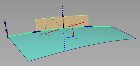

Type
Normal – Creates a surface that extends away at a given angle from the normal of the underlying surface(s). By default, the new surface is normal to the underlying surface(s).
Draft – Creates a surface that extends away at a given angle from a specified pull direction vector. By default, the surface is parallel to the pull vector.

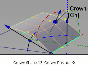

Proportional Crown
Select this option to raise or lower the midpoint or top of the draft surface so that the height or crown of the surface is proportional to the distance between the original curve and the top of the draft surface.
You can control the Proportional Crown directly on the surface.
Crown Value
Controls the height of the crown. The value corresponds to a percentage of the distance between the two rails. The slider ranges from 0.0 to 0.1, but larger values can be entered into the field.
Crown Shape
Increase the degree of the surface from 2 to 3, giving two central rows of CVs. Shape values less than 1 move these CVs closer to the edges of the surface, positive values move them closer to the center.
Flip Crown
Flips the direction of the crown. Click the arrow of the proportional crown manipulator to Flip the crown direction directly on the model.
Crown Position
This option controls the U direction of the crown shape from the middle of the draft surface to either end. When set to 0, the crown shape is at the middle of the surface. Increasing or decreasing this value moves the crown shape towards either end of the draft surface. Crown Shape must be set to a value greater than 0 before Crown Position has any effect.
Crown Type
Central – The first and last CVs in the V direction follow the draft angle, and the surface crowns in the center of the draft surface.
End – The first CV follows the draft angle, and the height of the crown is measured from the last CV relative to the draft angle.

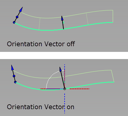

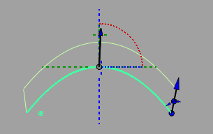

Orientation Vector
Allows you to reorient the flange edges to a vector. Use the Orientation Vector options to select or create a vector or use the manipulator to reorient the edges.

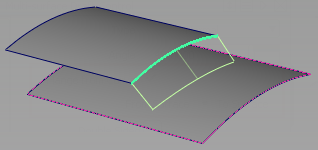

Modify Range
Modify Range
When this option is checked on, Start and End sliders appear in the control window, and arrow manipulators appear on the draft surfaces. Drag these arrows to modify the extent of the draft surfaces across the input curves.
When this option is checked off, the draft surfaces extend to the ends of the input curves.
Start/End
Use these sliders to modify the extent of the draft surfaces. Start and End values of 0.0 and 1.0 respectively, define the original extent.
Range of draft surface (in orange) extends from 0.25 (Start) to 0.75 (End).
