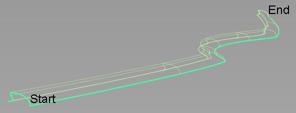

If several profiles are used, they can have different shapes but must have a similar structure (segmentation between sharp bends or number of spans). Each profile can have an individual position and orientation relative to the rail curve. If the curves within a profile set are disconnected (not G0), it is best to create a separate profile surface for each element of the set.
Rails can include curves and surface curves. Rails must be position and tangent continuous. They can be closed. You can use multiple tangent continuous rail curves with chain select or by making additional selections before accepting the rail input.

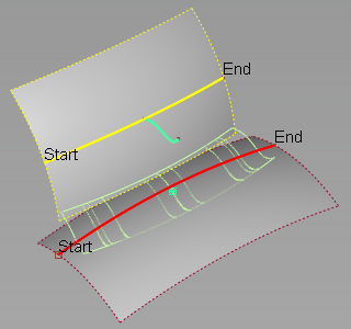

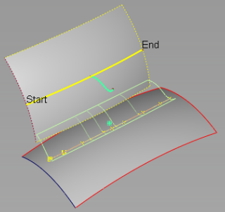

Rotate to Target – The profile rotates about the rail curve until it touches a selected Profile Target.
Rotate to Target Orientation, Surface Target, Radial Frame Travel
Rotate to Target Orientation, Curve Target, Radial Frame Travel
Slide to Target – The profile slides along an attached surface until it touches the selected Profile Target. The profile rotates so that the profile frame remains tangent to the sliding surface.
Slide to Target Orientation, Surface Target, Radial Travel
Slide to Target Orientation, Curve Target, Radial Travel

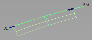

Modify Range
Modify Range
Select this option to define a portion of each rail as input for the profile surface using range manipulators, or using the Start and End sliders.
Setting the Start and End sliders to 0.0 and 1.0 resets the original extent.
