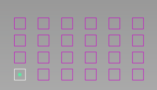

Linear – The array consists of rows and columns arranged in a rectangular pattern. The original object is located in the lower left corner.

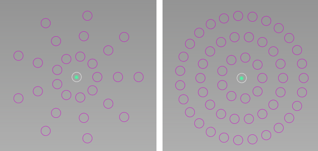

Radial – The array consist of "spokes" arranged radially around the original object. There is an option (Grow Radially) to increase the number of duplicates as the distance to the object increases, to create the appearance of concentric circles.
Left: Grow Radially = off; Right: Grow Radially = on

Grow Radially
This option is only available in Radial mode. When checked, the number of duplicates increases as the radius of its "row" increases. This technique helps create the appearance of concentric circles, rather than spokes.

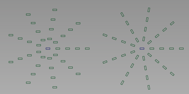

Rotate Duplicates
This option is only available in Radial mode. Check on to rotate duplicates around their local pivot by a relative value of Angle with respect to their orientation in the previous column (spoke).
Radial array with 9 spokes and Angle = 40. Left: Rotate Duplicates is OFF; Right: Rotate Duplicates is ON.
