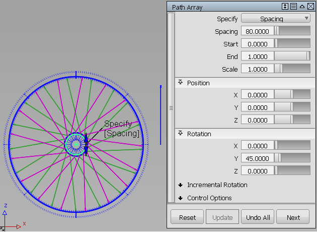

Spacing – The distance between the duplicates, in current units.
Number – The number of duplicates.
These values can also be set by using the corresponding manipulator on the model.
Specifies where the duplicates start and end along the curve. Start and End values of 0.0 and 1.0 respectively define the original extent.
These values can also be set by using the range manipulators on the path curve.

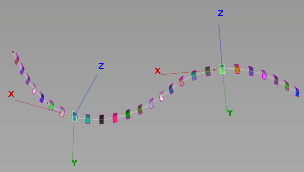

None – No change in orientation.
Tangent – The first copy of the object takes the original orientation and all subsequent copies are rotated based on the tangent of the input curve at the point where the object is being placed. This allows the arrayed objects to follow the flow of the input curve.
Normal – Aligns the local X axis of each duplicate with the tangent of the target curve at the position of the duplicate. If the target curve is a curve-on-surface, each duplicate is oriented so that its local Z axis matches the normal direction of the surface where the curve-on-surface lies. If the target curve is a free curve, the Z axis of each duplicate is oriented along the direction of the curvature vector of the curve (like plot combs).
If the curvature of the curve changes direction, the duplicates orientation does not flip at inflection points.
In the following image, a spoke (two surfaces, shown to the right of the bicycle wheel) is duplicated and placed along a circular path curve (inner rim). The operation is repeated twice to create two sets of spokes: one rotated by 45 degrees around Y (in pink), and the other rotated by 315 degrees around Y (in green).
