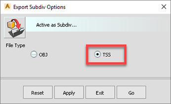

You can now export subdivision bodies (File > Export > Active as Subdiv) to T-splines TSS files. The T-spline file format maintains crease information and can be imported in other Autodesk products such as Dynamo, Fusion, and Speedform.
