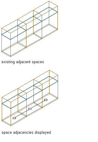

In most cases, adjacency relations between space surfaces are important for exporting and processing building plans to an engineering application. If you need to check the status of adjacency relations within AutoCAD Architecture 2021 toolset, you can make the adjacency relations visible in the drawing.
Displaying surface adjacencies
  1. On the command line, enter aecshowspaceandadjacencies.
  2. Adjacent space surfaces are displayed with lines.
  3. To hide the surface adjacency lines, press Enter.
