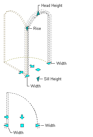

Objects in AutoCAD Architecture 2021 toolset have grips you can use to manipulate them. Pause the cursor on a grip to display a tooltip identifying the grip's function.
Door dimension grips

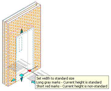

Many grip tooltips contain additional information on how to use the grip.
Displaying the tooltip for door standard size
