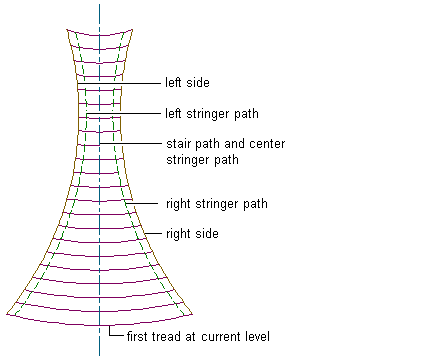

The stairs outline component of a custom stair is delineated by the left and right stair sides, the nosing of the first tread, and the front of the last tread or landing.
Stair stringers can be selected as linework, or they can be automatically generated by AutoCAD Architecture 2021 toolset. After you create a custom stair, you can replace stringer paths. You can add or modify stringers by editing the stair style. The stair style applied to the custom stair must have stringers defined in that particular stair style. If the stair style does include stringers, the left and right stringer path lines are converted to appropriate stringer geometry. The current stair properties govern the appearance of stair components in various representations.
Attention: The overall outline of the stair must not overlap at any point, or a Solution Tip will appear.
Create the linework for your custom stair using lines, light-weight polylines, or arc segments. All tread lines must intersect with the sides of the stair. Graphics representing the stringer paths must be continuous throught the path of the stair.
Linework for custom stairs can represent the following components:

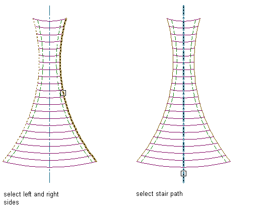

  4. Select the linework that represents the left and right sides of the custom stair.
    Only lines, light-weight polylines, or arc segments that intersect all treads can be selected for the stair sides.
  5. Select the linework that represents the stair path, or press Enter to have it generated automatically.
    Only single or multi-segment light-weight polylines or arc segments that intersect all treads can be selected for the stair path.

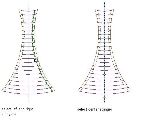

  6. Select the linework that represents the left, right, and center stair stringers, or press Enter to have the left, right, and center stair stringers generated automatically.

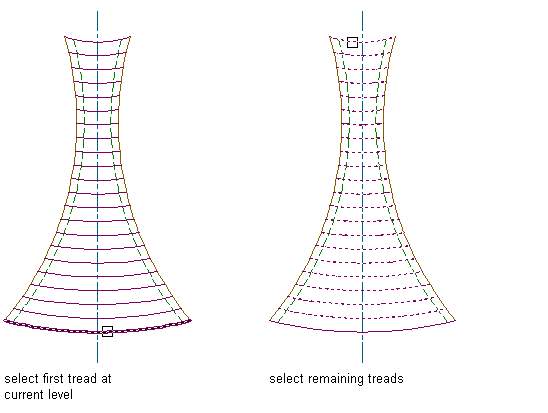

  7. Select the linework that represents the first tread at the current level.
    Only lines, light-weight polylines, or arc segments that intersect the stair sides can be selected for the stair treads.
  8. Select the remaining treads.
