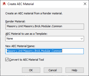

  5. If you have dragged the render material directly into an drawing, the Create AEC Material worksheet is displayed.
    • For AEC Material to use as a Template, select an existing material definition that contains the parameters you want to use.
      Note: The material definition you select as template will define all initial material settings except for the rendering material. These include the layer, color, and linetype settings, hatching, surface hatch assignments, and the behavior of the material when used in a section.
    • Enter a name for the new material definition.
    • Click OK.
    The option to automatically create a material tool from the new material definition is grayed out.
  6. If you have dragged the render material onto an AutoCAD Architecture 2021 toolset palette, finish the creation of the AEC Material tool.
    • Select the temporary icon on the tool palette.
    • In the Create AEC Material Worksheet, select an existing material definition for AEC Material to use as a Template.
      Note: The material definition you select as template will define all initial material settings except for the rending material. These include the layer, color, and linetype settings, hatching, surface hatch assignments, and the behavior of the material when used in a section.
    • Verify that Convert to AEC Material tool is selected.
    • Click OK.
      A notification message appears, reminding you to save the drawing after dismissing the notification so that the material tool is saved with the current drawing.

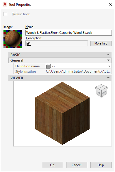

  7. If you have created a material tool by dragging a render material to a tool palette, update the tool image to display the AutoCAD Architecture 2021 toolset material tool icon.
  8. Select the material tool on the palette, right-click, and click Properties.
    You can see that the icon preview is different from the Viewer preview.
  9. Select the icon preview under Image, right-click, and click Refresh Image. Then, click OK.
    The material tool is now represented on the palette by the AutoCAD Architecture 2021 toolset cube icon with correct material display.
