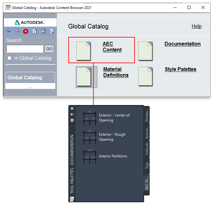

When multiple users are working on a large project, consistency of tools is especially important. Typically, the objects for the project and their styles and properties are set up by a CAD manager or system administrator, and then distributed to the team. The administrator can put tools and palettes in a central location in the Content Browser and link them to each user’s computer. Whenever the tools or palettes are updated in the Content Browser, they are updated on the users’ computers too.
Using tool palettes from the Content Browser
