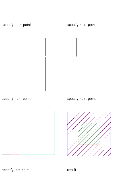

Specify the start point of the AEC polygon.
Specify further points to define the AEC polygon.
Note:
You must specify enough points to create at least three sides for the AEC polygon.
Enter
c
(Close) to close the AEC polygon.
