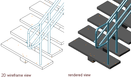

In AutoCAD Architecture 2021 toolset, you can assign materials to a railing. These materials are displayed in wireframe and working shade views, or when rendered. Materials have specific settings for the physical components of a railing, such as the various types of rails and posts, and the baluster. You could, for example, create a wooden railing with a stainless steel handrail and bottomrail.
Railing in 2D wireframe model and rendered views
AutoCAD Architecture 2021 toolset provides a number of predefined materials for common design purposes, which contain settings for railings. You can use these predefined materials “as is”, or modify them to your special designs. You can also create your own materials from scratch.
