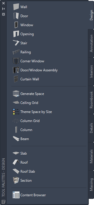

Tool palettes provided with AutoCAD Architecture 2021 toolset let you quickly place door/window assemblies by selecting a door/window assembly tool with a specific door/window assembly style and other predefined properties. When you place door/window assemblies using door/window assembly tools, you can use the default settings of the tool, or you can change settings for the door/window assembly properties. You can also use door/window assembly tools to convert linework to door/window assemblies and to apply the settings of a door/window assembly tool to existing door/window assemblies.
The following palettes contain one or more door/window assembly tools:
Tool Palette Door/Window Assembly Tools
Design palette in the Sample Palette catalog in the Content Browser Standard door/window assembly style and default settings for other door/window assembly properties
Design Tool Catalog Doors and Windows Door and Window Assemblies in the Content Browser a large number of door and window assembly styles for many design uses
custom tool palettes created by your CAD manager door/window assembly styles and properties that your CAD manager customized for your projects or office standards
