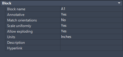

  5. On the Properties Palette, under Block, select Yes for Annotative.
