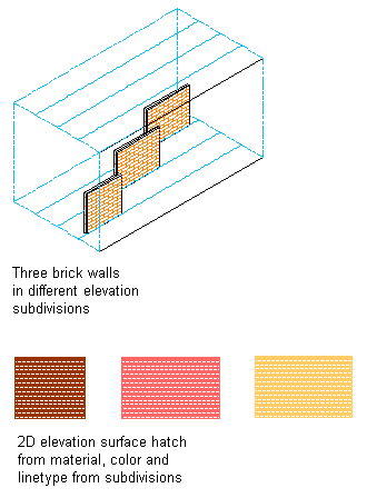

Subdivisions in 2D Elevation Styles and Materials
When you are creating subdivisions in your style, you usually want the objects in them to be visually distinct from other subdivisions. When you have assigned materials to the objects, you can set the 2D elevation style so that it uses the hatch pattern from the material, but uses the color and linetype from the subdivision display properties.
Elevation subdivisions with assigned surface hatching
