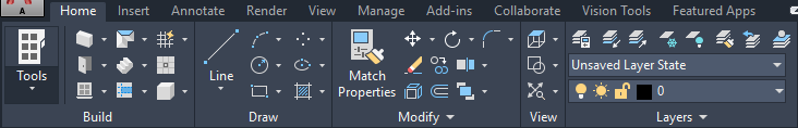

- Static tabs are available regardless of which objects are selected in the drawing area. The commands on these tabs were previously located on the menus and toolbars.
Static Home tab

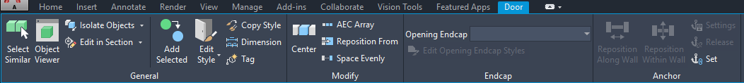

- Contextual tabs display depending on the object selected in the drawing area. When you select a door, a contextual tab for doors is displayed. The commands on the contextual tabs reflect the commands on the context menu of an object.
Contextual tab for door objects
