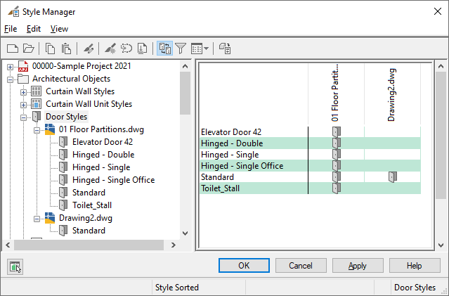

Standard styles can be accessed, edited, synchronized, copied, and updated in Style Manager.
Project standard styles in Style Manager
Standard styles are displayed in Style Manager. Depending on their status with regards to the project standards, there are a number of different icons to differentiate them.
