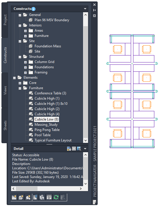

  1. On the Quick Access toolbar, click Project Navigator .
  2. On the Constructs tab, locate the element you want to open.
  3. Open the element using either of the following methods:
    • Select the element, right-click, and click Open.
    • Double-click the element.
    The element is opened in the drawing area of AutoCAD Architecture 2021 toolset. You can now edit it.
