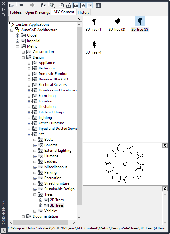

Like the Content Browser, DesignCenter™ also lets you store, organize, share, and exchange AEC content that can be inserted into drawings. Instead of being tool-based, however, AEC content in DesignCenter is organized in a hierarchical tree view, and once you select an AEC content item, you can preview it, edit it, or drag it onto a tool palette or directly into a drawing.
When you open the DesignCenter from the Palettes panel drop-down on the View tab, and click the AEC Content tab, the Custom Applications tree view is displayed in the left pane with AutoCAD Architecture 2021 toolset as the root node. Within the Imperial and Metric folders under the root node, there are folders for categories that roughly approximate the CSI MasterFormat 2004 divisions. At the lowest level of the tree view, each folder points to one or more external drawing files, each containing one piece of AEC content. You can toggle the tree view on and off by clicking at the top of the DesignCenter window.
There are 3 panes on the right side of the AEC Content tab.
The AEC Content tab in DesignCenter
