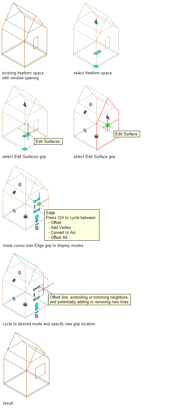

3D freeform space surface openings can be edited like any profile-based boundary in AutoCAD Architecture 2021 toolset. The opening boundary has vertex and edge grips to generate the desired shape.
  1. Select the space on which you want to edit the edge of a surface opening, and click the Edit Surfaces grip.
  2. Click the grip for the surface with the opening you want to edit.
  3. Select the Edge grip for the edge you want to change.
    Offsetting the edge of a window opening on a freeform space surface

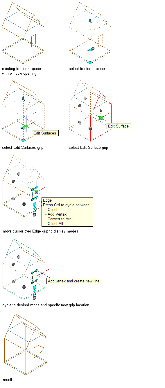

    Adding a vertex to the edge of a window opening on a freeform space surface

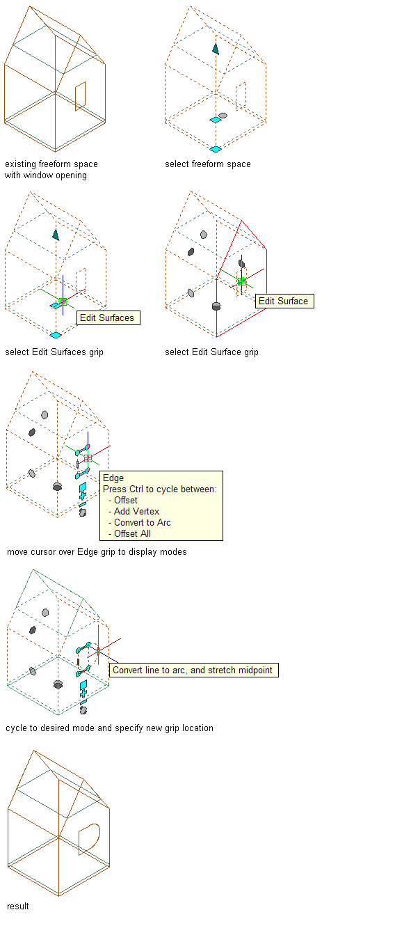

    Converting the edge of a window opening to arc on a freeform space surface

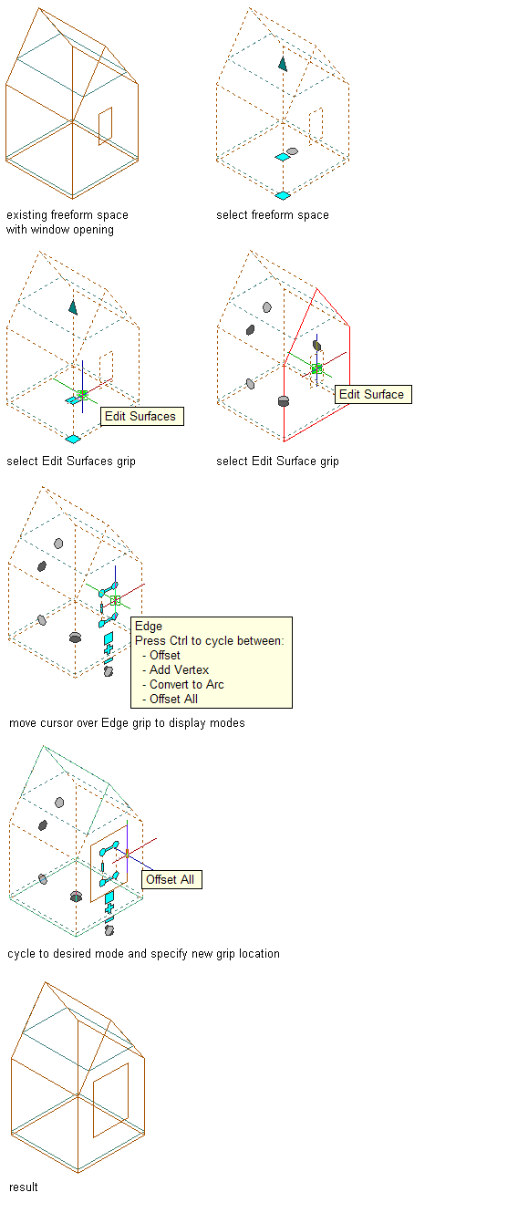

    Offsetting all edges of a window opening on a freeform space surface
  4. Specify the new edge location:
    If you want to… Then…
    offset the edge move the edge to the desired location, and click; or enter a value, and press Enter.
    add a vertex and create an edge press Ctrl to switch to the Add Vertex edit mode. Move the edge to the desired location, and click; or enter a value, and press Enter.
    change a selected edge to an arc/change a selected arc to a line press Ctrl twice to switch to the Convert to Arc/Convert to Line edit mode. Stretch the midpoint to the desired location, and click; or enter a value, and press Enter.
    offset all edges at an identical distance press Ctrl 3 times to switch to the Offset All edit mode. Move the selected edge to the desired location for all edges, and click; or enter a value, and press Enter.
