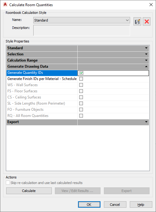

Click
Vision Tools tab
Roombook panel
Calculate Room Quantities
In the Calculate Room Quantities dialog box, under Style Properties, Generate Drawing Data list, select Generate Quantity IDs.
Click OK.
