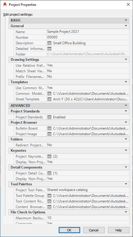

  1. Click Open Project.
  2. Select the project for which you want to specify the tool palette group and the Content Browser library, right-click, and click Project Properties.
  3. Under Tool Palette Group, specify the location of the project tool palette group. You can select a local folder or a network folder here.
    If you do not explicitly set a location here, the following default behavior is selected depending on how you created your project:

  4. For Project Tool Palette Group, select Shared Workspace Catalog or Per User Workspace Catalog.
    If you select Shared Workspace Catalog, the path selected under Tool Palette File Location is added to the user’s project profile (AWS), and the tool catalog is used from the specified location. If you select Per User Workspace Catalog, a folder is created under \\Documents and Settings\<User Name>\ and the tool palettes are copied to that folder.
  5. Under Tool Content Root Path, you can set a root path for the tools used in the project tool palette group. When tools on project palettes are created with the tool content root path specified in the project setup, the content root path is created as a variable (%AECPROJECT_DIR%). When the tool content root path in the project setup is changed, and the referenced style drawings are moved to the new location, the path of the project tools is changed accordingly.
    Note: When a project is re-pathed, and the content root path is within the project folder, then it will be re-pathed accordingly.
  6. Under Content Browser Library, select the default Content Browser library (CBL) to be displayed when opening Content Browser from the Project Navigator.
  7. Click OK.
