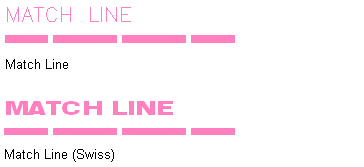

About Match Line Tools
Match line annotations are used for annotating a drawing. Formerly available as content blocks in DesignCenter, these annotations are now available through tools on the tool palettes and in Content Browser.
Match line tools
By default, all match line tools are set to be annotative, which means that the annotations you insert with these tools are controlled by annotative scaling.

General/Linetype Specifies the linetype of the match line. For the match line tools shipped with AutoCAD Architecture 2021 toolset, linetype Aec_Match_Line is specified. This linetype has been added to the acad.lin and acadISO.lin files.
