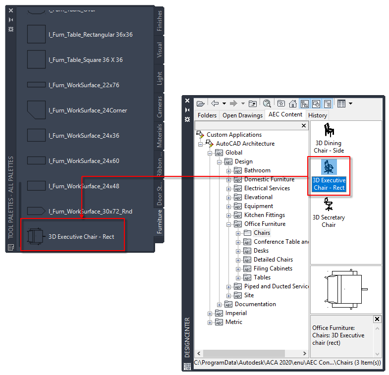

Creating a tool from AEC Content in DesignCenter
  1. Open the tool palette where you want to create the new tool.
  2. Click Insert tabContent panelContent Browser drop-downDesign Center, and navigate to the AEC Content item from which you want to create a tool.
  3. Drag the item to the tool palette.
    A new tool is inserted on the tool palette.
    Note: An AEC Content tool uses the last-used viewer settings for a tool of this type to generate the tool icon. If the last-used viewer setting is Gouraud 3D view, and the user creates a tool from a 2D AEC Content item, the tool icon will be invisible. In this case, you need to change the viewer setting of the tool to a Top view, and wireframe.
