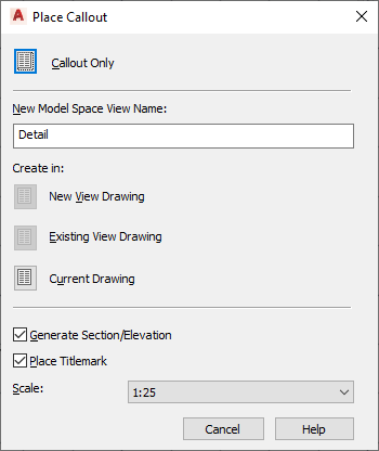

  9. Under New Model Space View Name, enter a name for the new model space view containing the detail.
  10. If necessary, select Generate Section/Elevation.
  11. If you want to add a title mark to the model space view, select Place Titlemark.
  12. Select the scale for the model space view.
  13. Click Current Drawing.
  14. If you selected to create a detail with a section/elevation, specify the insertion point of the 2D section/elevation result.
  15. If you selected to create a detail without a section/elevation, specify the extents of the model space view containing the area being detailed.
