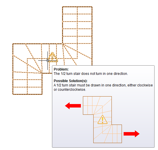

When AutoCAD Architecture 2021 toolset detects a problem with the way a stair object is drawn, it displays a solution tip icon on the stair in the drawing.
Stair with solution tip icon
Move the cursor over the icon to display a message that describes the problem and provides one or more possible solutions. Where more detailed instructions are required, you can press F1 to access the relevant topic in Help.
A number of the solution tips for stair objects identify an invalid configuration for a particular type of stair. The F1 links for these tips bring you to this topic and the following table, which shows and describes the different types of stairs you can draw in AutoCAD Architecture 2021 toolset. Follow the associated links to specific instructions for drawing each type of stair.
