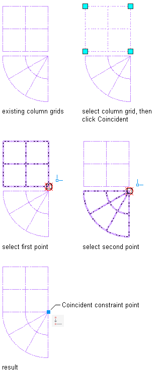

Working with the Coincident constraint
    The Coincident constraint constrains 2 points to coincide. The constrained points can lie directly on an AEC object, or the extension of an AEC object. The Coincident constraint also works between appropriate AEC objects and AutoCAD objects, such as a wall segment and a line.
    Use a Coincident constraint to anchor 2 column grids together.
  1. Select a column grid.
  2. Click Column Grid tabParametric panelCoincident .
  3. Select a corner point on the first column grid to constrain.
    The selected point is shown with a red circle and X through its center.
  4. Select a corresponding corner point on the second column grid to constrain.
    When you move one of the column grids, the other one moves with it. You can also rotate one of the column grids about the Coincident constraint point. To fully constrain both grids, add another Coincident constraint to the other column grid corner.

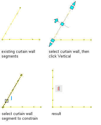

Working with the Vertical Constraint
    The Vertical constraint constrains lines or pairs of points on AEC objects to lie parallel to the Y-axis of the current UCS. When you specify 2 points to vertically constrain, the second point is made vertical to the first point.
    Use a Vertical constraint to realign a curtain wall segment vertically.
  1. Select the curtain wall segment.
  2. Click Curtain Wall tabParametric panelVertical .
  3. Specify a point on the curtain wall segment near the end that you want to remain fixed.
    The curtain wall segment end closest to the specified point becomes the pivot point.

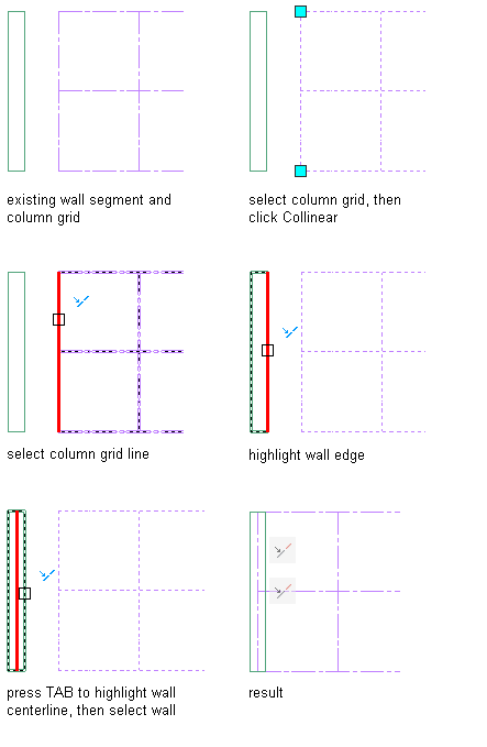

Working with the Collinear Constraint
    The Collinear constraint aligns one AEC object with another. The second selected AEC object is made collinear with the first selected AEC object. You can align edges or centerlines of AEC objects as necessary. The Collinear constraint also works between appropriate AEC objects and AutoCAD objects, such as a column grid and a line.
    Use a Collinear constraint to align the centerline of a wall with a column grid line.
  1. Select the column grid.
  2. Click Column Grid tabParametric panelCollinear .
  3. Hover your cursor over the column grid line.
    The grid line is highlighted with a red line.
  4. Select the red grid line.
  5. Hover your cursor over the edge of the wall segment.
    The wall segment edge is highlighted with a red line.
  6. Press Tab to highlight the wall centerline.
    The wall segment centerline is highlighted with a red line.
  7. Select the wall segment.

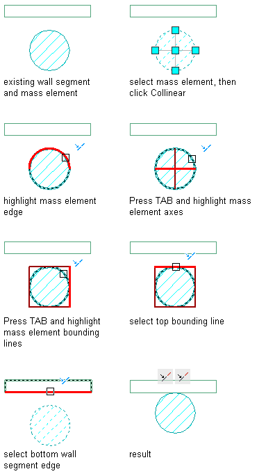

    Use a Collinear constraint to align the edge of a mass element with the edge of a wall segment.
  1. Select the mass element.
  2. Click Mass Element tabParametric panelCollinear .
  3. Hover your cursor over the edge of the mass element.
    The top edge of the mass element is highlighted with a red line.
  4. Press Tab to highlight the mass element X and Y axes.
    The X axis is highlighted with a red line.
  5. Press Tab to highlight the mass element bounding box.
    The right bounding box line is highlighted with a red line.
  6. Select the top bounding box line of the mass element.
  7. Select the bottom edge of the wall segment.

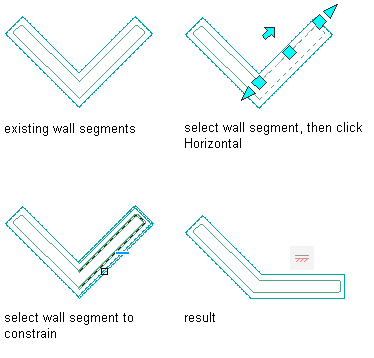

Working with the Horizontal Constraint
    The Horizontal constraint constrains lines or pairs of points on AEC objects to lie parallel to the X-axis of the current UCS. When you specify 2 points to horizontally constrain, the second point is made horizontal to the first point.
    Use a Horizontal constraint to realign a wall segment horizontally.
  1. Select the wall segment.
  2. Click Wall tabParametric panelHorizontal .
  3. Specify a point on the wall segment near the end that you want to remain fixed.
    The wall segment end closest to the specified point becomes the pivot point.

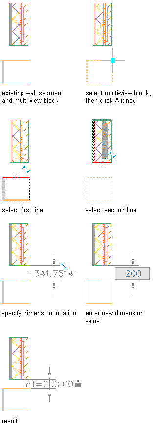

Working with the Aligned Constraint
    The Aligned constraint maintains the distance between 2 parallel elements on 2 different AEC objects.
    Use an Aligned constraint to maintain a specific distance between a wall segment and a multi-view block.
  1. Select the multi-view block.
  2. Click Multi-View Block tabParametric panelAligned .
  3. Select the edge of the multi-view block.
  4. Select the edge of the wall segment.
  5. Specify the dimension location.
  6. Enter a new dimension value.
    When you move either AEC object, the specified distance between them is maintained.

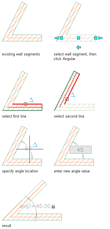

Working with the Angular Constraint
    The Angular constraint maintains a specific angle between 2 AEC objects. The Angular constraint also works between appropriate AEC objects and AutoCAD objects, such as a wall segment and a line.
    Use an Angular constraint to maintain an angle between 2 attached wall segments.
  2. Click Wall tabParametric panelAngular .
  3. Select the first wall segment edge as the angle baseline.
  4. Select the second wall segment edge to constrain.
  5. Specify an angle location.
  6. Enter a new angle value.
    When you move either AEC object, the specified angle between them is maintained.

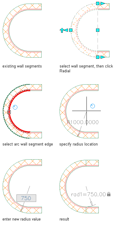

Working with the Radial Constraint
    The Radial constraint maintains a specific radius of an AEC object. The Radial constraint also works between appropriate AEC objects and AutoCAD objects, such as a wall segment and a line.
    Use a Radial constraint to maintain the radius of an arc wall segment.
  1. Select the arc wall segment.
  2. Click Wall tabParametric panelRadial .
  3. Select the arc wall segment edge.
  4. Specify the radius location.
  5. Enter a new radius value.
