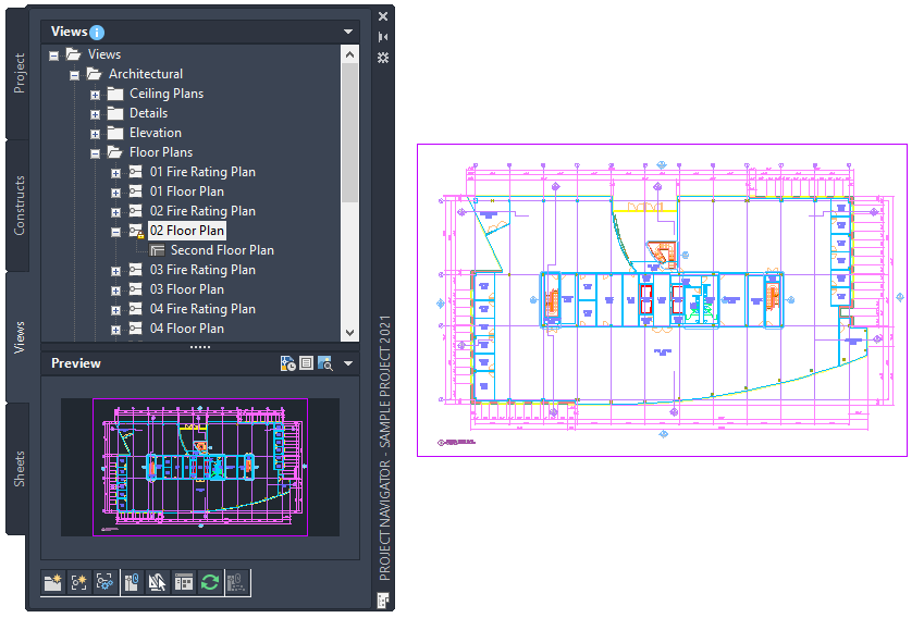

  1. On the Quick Access toolbar, click Project Navigator .
  2. Click the Views tab.
  3. In the Drawing Explorer, locate the view drawing you want to open.
  4. Open the view drawing using one of the following methods:
    • Select the view drawing, right-click, and click Open.
    • Double-click the view drawing.
    The view drawing opens in the drawing area of AutoCAD Architecture 2021 toolset.
