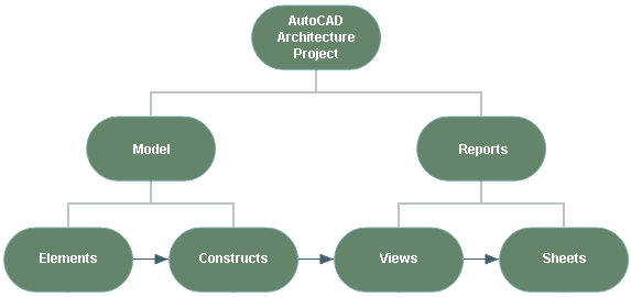

Project
At the highest level, building models are organized conceptually into projects. A project is composed of 2 parts: the building model and the reports generated from the model. The building model is composed of constructs and elements, while reports consist of views and sheets. Within a project, constructs are referenced into views, and views are referenced into sheets.

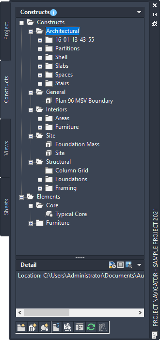

Constructs
A construct describes one unique portion of a building and is assigned to a specific level and division within the project. Spanning constructs, like curtain walls, can be assigned to multiple levels and divisions.
For example, the first level of your building project may consist of an exterior shell construct, a first-level core construct, and a first-level interior partitions construct.
A construct can contain drawing objects like walls and doors, external references to elements, or a combination of both. For example, a first-level core construct can contain the core walls directly drawn into the construct and an elevator element inserted as an external reference.
You can create and modify constructs within the current project. You can also import drawings and convert them or add them to constructs. You can import constructs into the project physically or by creating a link.
Constructs are referenced into views.

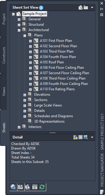

Sheets
Sheets are used to plot drawings of your building project.
The sheet system in AutoCAD Architecture 2021 toolset consists of the following components:
Sheet set, sheets, sheet views, sheet drawings, and model space views are listed on the Sheets and Views tabs of the Project Navigator.
Although it is recommended to place annotation in a view, you can add annotation like tags, dimensions, and schedule tables to a sheet.

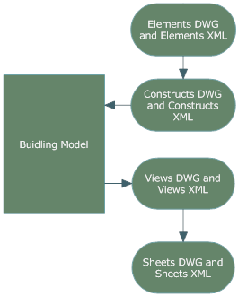

XML Structure
An AutoCAD Architecture 2021 toolset project has an underlying XML structure. For each drawing file you create—for example, a floor drawing or a structural drawing—an accompanying XML file is created. The XML file contains project-relevant information, such as level and division information. You can reuse any drawing file created within a project outside the project as well, because the drawing file itself does not contain project-relevant information.

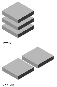

Levels and Divisions
The project provides a framework of levels (floors) and divisions (wings) that specify where in the building project constructs are located. By default, a new project consists of one level and one division. You can add levels and divisions throughout the lifetime of a project. The matrix of levels and divisions provide the framework to help uniquely identify the building components. For example, you could have a construct in your building assigned to First Floor—West Wing.
Levels and divisions schematic
Building objects, such as curtain walls and elevator shafts, can span multiple levels and divisions. You can use a spanning construct for these types of building objects.

Construct categories in the Project Navigator
