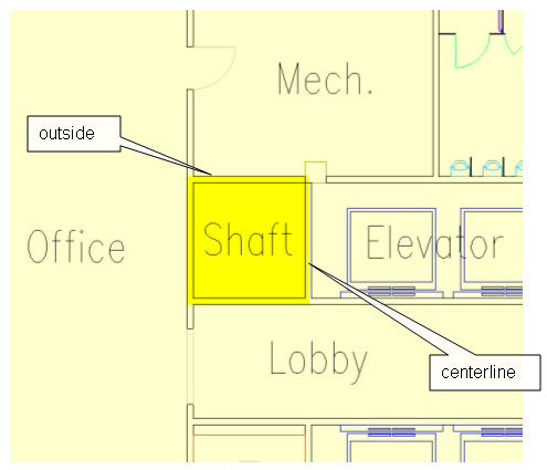

Usable Area (Space Type_BOMA: MVP) | |
Adjacent Spaces | Boundary |
Office, Store, BCA, FCA | Measured from outside face of wall |
MVP | Measured from centerline of wall |
