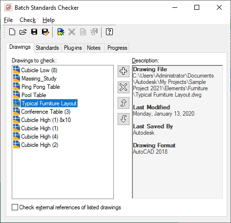

  4. Click File menu Open Check File.
  5. In the File Open dialog box, select the project CHX file.
    Batch Standards Checker
  6. Click Check menu Start Check.
