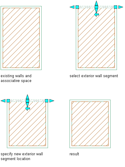

About Updating Associative Spaces
Associative spaces are defined by their boundary objects and are updated when the boundary objects change. You can choose to have associative spaces update automatically whenever there is a relevant change to boundary objects, or you can choose to perform the space update manually.
Updating Associative Spaces Bounded by External References
Objects in external references can serve as boundary objects for associative spaces in the host drawing. When the objects in the external reference change, the space is updated too. In previous versions, a manual update was necessary to propagate changes in the external reference’s boundary objects to the spaces in the host drawing; now changes from external references are automatically updated when reloading the external reference, if the automatic update of associative spaces is activated.
