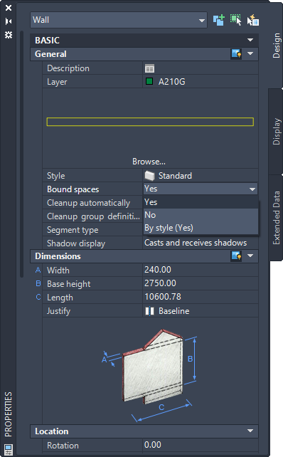

  1. Select the object for which you want to set the Bound Spaces property, and double-click.
  2. In the Properties palette, display the Bound Spaces setting in one the following locations:
    Object Type Location of Bound Spaces property
    Architectural objects: Expand the General category.
    Linework objects: Expand the Advanced category.
    Note: The Bound Spaces property will not be displayed when opening the drawing in an AutoCAD Architecture 2021 toolset Object Enabler environment such as AutoCAD, Civil 3D, or Land Desktop, or when you run AutoCAD Architecture 2021 toolset as AutoCAD. It will only be displayed in full installations of AutoCAD Architecture and MEP toolsets.
  3. For Bound Spaces, select one of the following options:
    • By Style (Yes/No): This object uses the Bound Spaces setting defined in the object’s style. This is the default setting for objects that have styles.
    • Yes: this object can bound associative spaces.
    • No: this object cannot bound associative spaces.
