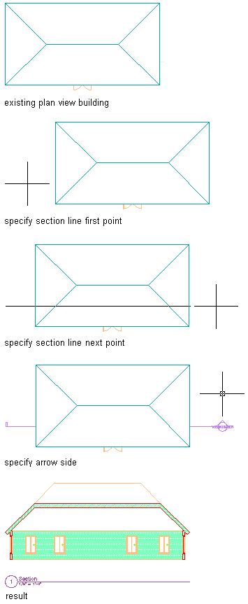

The section line defines the extents of the section that you extract from the building model. Sections lines can be straight or jogged. You can also specify the length, depth and height of the area defined by the section line. Section marks, which typically contain a letter or number and indicate the direction of the section, appear at each end of the section line.
Note: By default, the height of the section line is the extent or height of the model. If you wish to change the height, select the section line and in the Properties palette, change the value of 'Use Model Extents for Height' to No.
After you draw the section line, you can create a section object or a live section view from the line.
