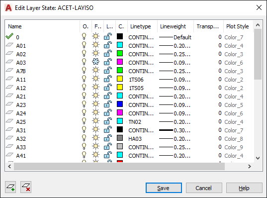

Modifies the selected layer state.
LAYER (Command) Find:
Displays all the layers and their properties that are saved in the selected layer state.
The following options are displayed.
Displays a list of layers in the selected layer state and their properties.
Removes the selected layers from the layer state.
Displays the Select Layers to Add to Layer States dialog box, in which you can add layers from the current drawing that are not defined in the layer state.
