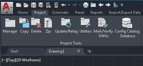

As part of our continuous efforts to provide a great visual experience to our customers, the AutoCAD Electrical 2020 toolset release has new 'flat designed' icons in the user interface for command window and toolbars.
AutoCAD Electrical user interfaces are now optimized to work with high resolution monitors. As a result, dialog boxes such as the Bill of Material, Electrical Audit, Footprint Lookup and Schematic Terminal, dialog boxes scale correctly when you increase the text size in Windows display properties.
Your user interface is obviously something that you use all the time. Past customer feedback repeatedly indicated that we needed to make significant changes to improve the clarity and crispness of the dark theme. Similar sharpening was also applied to the light theme as well.
As you can see, we optimized the background colors with the icon colors to provide the optimum contrast without distracting from the drawing area, where you're usually focused.
