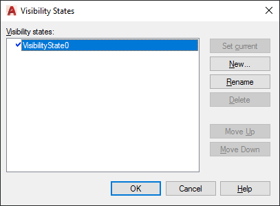

Creates or modifies visibility states for a dynamic block definition.
BVSTATE (Command) Find
The following options are displayed.
Lists the available visibility states for the current dynamic block definition. The order of this list is reflected in the dynamic block reference when the grip is clicked to display the list of visibility states. The state at the top of the list is the default state for the block reference.
Sets the selected visibility state as the current state to display in the Block Editor. Does not change the default visibility state that is displayed when the block is inserted in a drawing, nor does it change the displayed visibility state for block references already inserted and edited in the drawing.
Displays the New Visibility State dialog box.
Renames the selected visibility state.
Deletes the selected visibility state.
Moves the selected visibility state up in the list.
Moves the selected visibility state down in the list.
