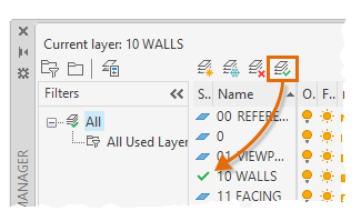

All new objects are drawn on the current layer by default. The green check mark on the Layer Properties Manager indicates the current layer.
